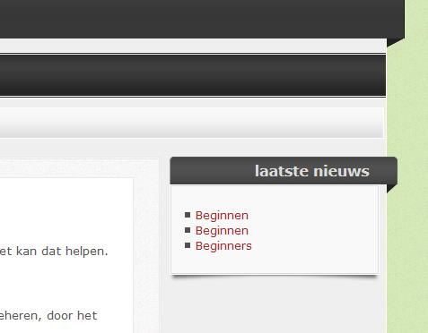

12 Jahre 3 Monate her #596
von GertJan
GertJan antwortete auf difference
12 Jahre 3 Monate her #597
Thomas Hunziker antwortete auf difference
The template by itself isn't really fully responsible. It's something that still can be improved. I'm not sure yet about the best approach.
The content part should be.

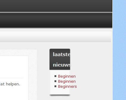

12 Jahre 3 Monate her #598
von GertJan
12 Jahre 3 Monate her #599
I actually would have to see the website to really tell. But looks like a wrong "Bootstrap Size" to me. It's a parameter in the advanced tab of your module. Make sure it's set to 0 or 12 unless you know what you do
Most templates don't support this parameter, but mine does
