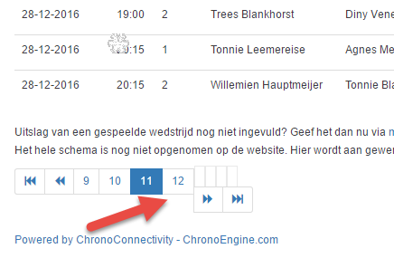

Hi
I use the component ChronoConnectivity v5 at my site for display some database tables..
One of the options from that component is that the paginator function can be used.
But this option doesn't qua styling not properly.... It works... oke.. that's fair but the displaying not correct.
It displaying oke in an another template but not in this one
how to fix this problem
see the image for details
thnx in advance

9 Jahre 11 Monate her #2634
Matthias antwortete auf Paginator from CCv5 doesn't work
Hi,
if I get the link to a page with this problem, I should be able to find the reason for this bad layout
Matthias
Matthias

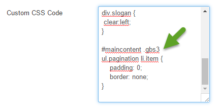

9 Jahre 11 Monate her #2636
The following CSS-Code should solve the problem:
#maincontent .gbs3 ul.pagination li.item {
padding: 0;
border: none;
9 Jahre 11 Monate her #2637
von Dirk
Dirk antwortete auf Paginator from CCv5 doesn't work
I add the code to the custom code but sorry.. it doesn't fit the issue
9 Jahre 11 Monate her #2638
Did you added the code in the active Style of the template?
Did you saved the changes?
I can not see the added CSS-Code.
